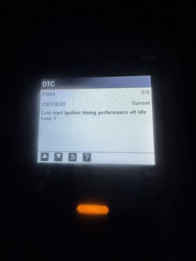

these are all the codes idk im so lost
I don't know what kind of scan tool you are using, but you may consider taking it back for a refund.

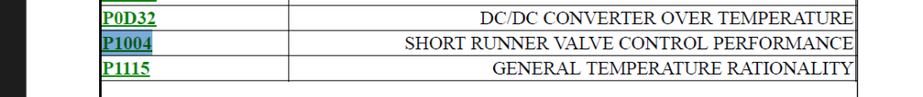

P1004 is has nothing to do with cold start ignition timing. P1004 is the short runner actuator in the intake manifold:
From my factory service manual:

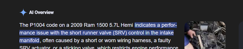

From google:
P0113 was probably set when someone started the engine with the IAT sensor disconnected. In the video below, ray unplugs the IAT at the 1min 28sec point. Turning on the truck with that little guy disconnected probably caused the p0113. I wouldn't worry about that one for now.
A short runner code and misfire under load can indeed cause "not enough air", but this is NOT going to be fixed with an aftermarket cold air intake.
