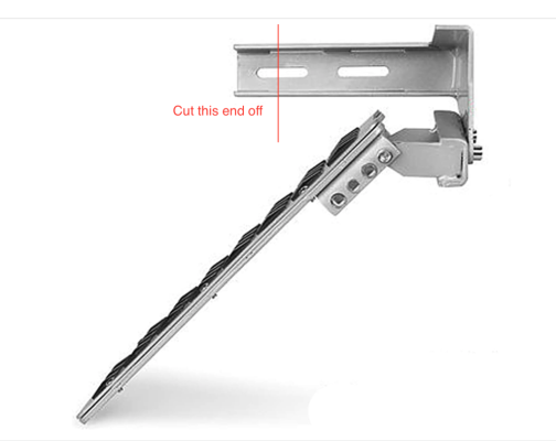

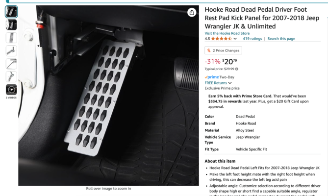

I used this one for a Jeep JK. It just needed a slight modification of cutting the end off of the mounting bracket. It slipped in right behind a little scalloped area on the inner layer of the side kick panel. I just drilled and tapped two 1/4 inch holes and screwed it on. Then just a little trimming of the plastic trim panel cover. Works great.
