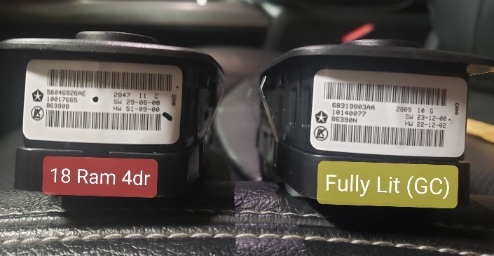

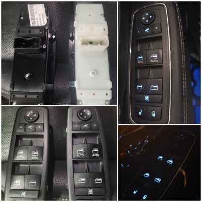

What are the chances the switch mainboards are the same between the 2dr and 4dr Models? I saw a teardown of one on Youtube and the top part of the switch housing is all one piece and the mainboard comes out separately.
I think @bellaireroad was leaning towards that, but the fact that he just sold me his 4-door power window switch makes me believe that is not an option.
I doubt they are the same (1 connectors vs 2), but I may try to crack open my original 4dr power fold switch to see if there are pads on the board to solder LEDs/compare if I don't just sell my original one.

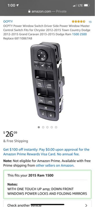

Just fyi for any folks replacing the switch i can confirm this non oem switch works well, not a lighted fold button but, works same as as oem.
