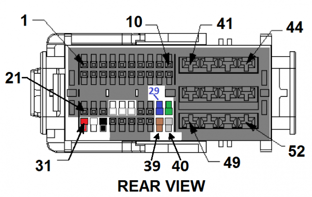

So if I want my side mirrors to dim, I could get the 911/Assist AutoDim rear view mirror 68096091AF + covers. Would I need a different wiring harness?
Wow, love that link! Says pins 29 and 30 are for the microphone. The diagram points out pin 31-40. But is pin 30 directly "below" pin 40, or is it "below" pin 31?
Thanks!

Your current manual dim mirror harness won't work, you need one of the mirrors below and either one of the 2 harnesses. Just have to decide if yo may want to add the extras that come with the second harness for your 2014 1500...
. . 911/Assist AutoDimming Mirror: - 68096091AF (Req's Sales Code) (2013-2016 Trucks)
. . . (AutoDim Mirror Mount Covers: Upper - 1ZA39DX9AA & Lower - 1YW13DX9AB )
. . or 911/AutoDim w/AutoHighBeam Mirror: - 68096094AA (Req's Sales Code)
. . . (AutoDim w/AutoHighBeam Covers: Upper - 1ZA39DX9AA & Lower - 1YW14DX9AC )
- Mirror Header harness (Standard/Autodim): 68207372AB
- Mirror Header harness (premium, ie 14+ 1500's with Humidity & Rain Sensor plugs) : 68207371AD
** ATC Humidity sensor needs additional wire on male/ truck side **

Thanks for clearing up where pins 29/30 are in relation to other pins, except why are the numbers in your diagram flipped upside down from the diagram from connectors.dcctools.com? And, do you think I am risking damaging the microphone port on my aftermarket radio by feeding the oem mirror microhone into it?

AlfaOBD will list the factory microphone type/resistance in your truck... Whether that's compatible with your aftermarket radio is unknown.
The DCCtools connector site shows the connector from the front. I manually edited the picture.
