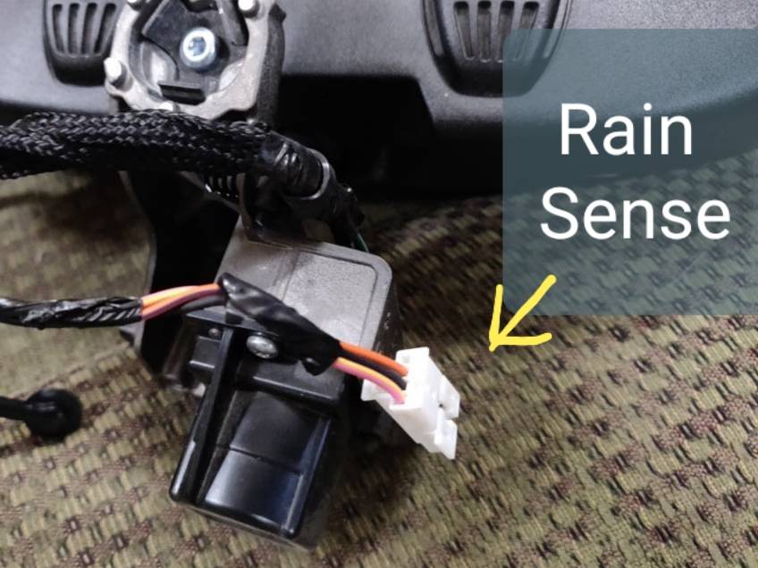

The difference in the new harness should be the extra 4pin connector near the mirror connector for the rain sensor (Auto wipers). Got pictures?
(What's the PN on your current factory 17 2500 harness & original mirror/features.)
68309105AA - (2017 2500, uConnect, ATC, no cab lights) only it has SmartBeam and rain sense wipers.
FYI: main difference between 13-16 and 17-18 (19 classic) mirror harness is that they removed the extra 4 wires for the 2 mics (moved the wires to driver side connector going up to the headliner)
Edit: added picture of the rain sensor connector...
M² Mods.
M² Mods.
