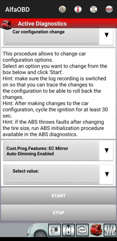

Anyone know if there is supposed to be a soft key in the radio for turning the auto dim mirror function on and off?
Trying to catch up on all the messages etc.
Try this....

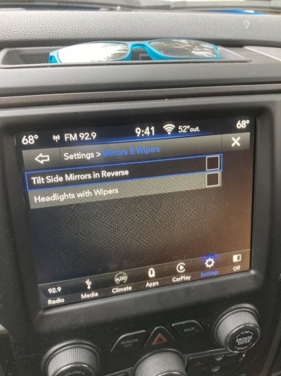

I have the UAS, it’s a 2019 Classic. Just upgraded my manual dim mirror with an auto dim with smart beam. Did not appear that I needed to replace the header harness. I updated all the settings, I have the soft key for the auto high beam, but I don’t see one for the auto dim. I also confirmed for auto high beam, it indicates it’s on/off in the EVIC when I turn the high beams on/off, I just haven’t tested everything while driving at night yet. Just can’t find a soft key for the auto dim anywhere. Assumed it would be under the mirror settings but it isn’t. And I’ve checked a few other places as well.

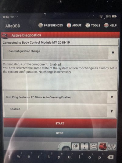

Can you please tell me what settings you changed with alpha for this mirror upgrade ?
If you want you can pm and I can give you my email address and we can compare bcm logs .

If you could tell me where the soft key is located that would be great. I don’t seem to have anything labeled controls under the settings. Just took a drive and smart beam seems to be working no problem, just can’t get the auto dim mirrors working.

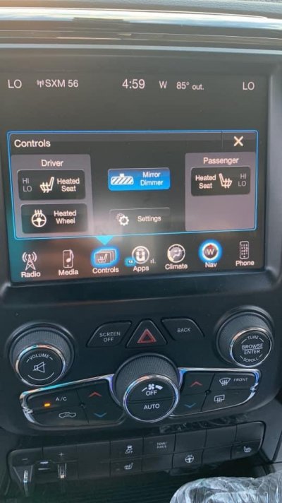

Hi Skuppy,
Correct, my truck is an express, no heated/cooled, or power seat. It did come with the UAS and 7” EVIC. I upgraded the side view mirrors to power fold with memory (I don’t use the tilt in reverse though). And I just recently upgraded my manual dim mirror with the auto dim/smart beam mirror. Just confirmed smart beam is working correctly and there is a soft key to turn it on and off. Can’t find a soft key for the auto dim and not 100% sure if it is working or not. Tried shining my phone light on it and watching my drivers side mirror to see if it dimmed but couldn’t really see much. I’ll shoot you a PM.

Sounds like I have to get the ‘Controls’ section added under settings somehow…

Yeah I definitely don’t have this since I don’t have any of those options showing (other than just adding the auto dim). Wondering if I say my truck has a heated wheel if the ‘controls’ section will show up.
