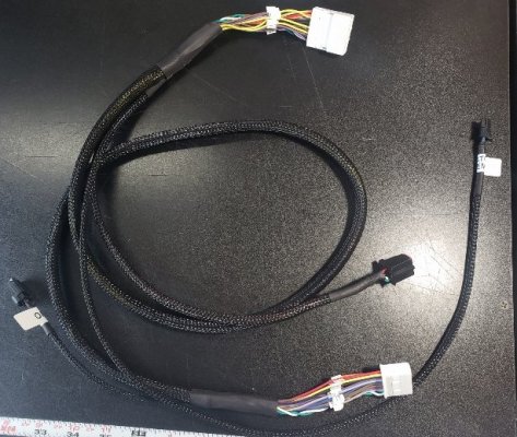

Ready for prime time ....
True universal 8.4 primary conversion harness (v4)... with:
- 4spd/7spd support in same harness
>> Just add our plug n play fan harness for 2500/3500 4 speed fan trucks
- Single Zone ATC part 1 built in
>> Just add our ATC part 2 harness if needed (for 14+ 1500's/classic)
- Support for Dual Zone ATC ... For those wanting to add extra blend door.
>> Will have to custom build rest of blend door wiring into add-on harness
Will be same price as current harness with ATC Pt1 built in.

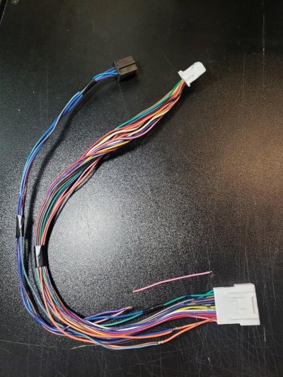

Someone gave me a harness they got from elsewhere (before replacing it with ours to fix their problems) ...
Ours (see above):
- factory/FCA rated automotive wire
- Proper crimps/splices/harness protection
- Actual support before/after the sale
Compare the difference.
Theirs:
- thin stand/brittle generic 22awg hook up wire breaks easy.
- Taped splices (did solder them though)
- pins crimped correctly. I've seen worse.
* Can't fix this one.
'Someone' is apparently selling the original style 4 to 7 Speed fan /resistor harness' for 2500/3500's with poor crimps/small wire that's melting/burning up terminals at the i32A-7 connector behind the passenger kick panel. Be careful. (Would be great if that person with problem would post pictures)17ccb52f121b163fbcf4c0c1e99c0459.jpg
