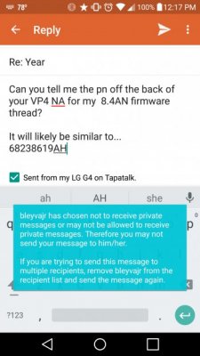

Can you tell me the model year and part number for your 8.4AN/VP4 NA?
Sent from my LG G4 on Tapatalk.
@bleyvajr,
Your settings do not allow you to receive PM's...
Can you post the part number off the back of your 2015 8.4AN/VP4 NA radio please?

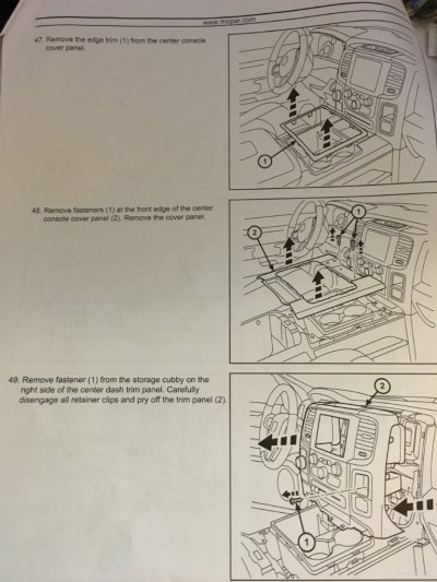

What he said. If you don't have a center console it's just the two screws. It will pop off. I am not sure why yours seems so hard. If you do have the center console then there are two more screws under the console where it meets the bottom of the dash. If I remember correctly yours did not have the console so you should just have the two screws. If you go on YouTube and search for 8.4 upgrade from O.E.M auto parts.com there is a video of them removing the bezel. It's really very strait foward..
Rick a friend of a friend supposedly has a wrecked Ram 1500 with a center console, I want at least the bezel if it good shape, where are the lower screws to get that off and do the side end pieces of the center console need to come off first to get to those lower screws?
Thanks
Since I am asking do you know where and how many screws actually get the center console out as well? I don't have one so no clue.
Again tks
jackblackjeet
Jul 14, 2015
238
134
St Louis, MO
Thanks
Again tks
This should help to get the radio trim out. Not sure About the full console since I don't have one either.
