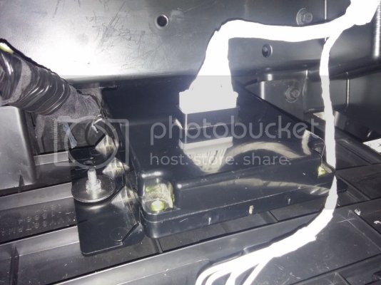

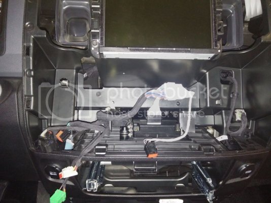

Heres a few pics of where I located the module inside the dash and a few others. I didnt go too crazy but wanted the module solid and not hanging in there. I removed the lower drawer, drilled 2 holes and mounted it where you see.
Testing the ATC besel (which works fine)
Module mounted.
Since the top of the surface where its mounted was not flat I just spaced up the area with washers, installed the module, used a small rubber washer under the large washer which you can see and snugged it down.
All buttoned up till my MTC bezel shows up next week
