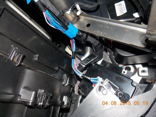

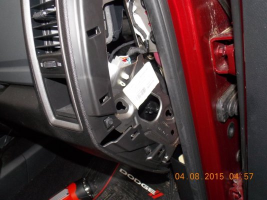

Annoucement: We now are building extended length harnesses! Now you can relocate your HVAC module to the factory mounting location behind the glove box. Simply Select it from the drop down menu on the harness selection page on our website.
2 questions...
1. On the website it only shows 4 speed extended length. Is there one for the 7 speed?
2. Where exactly is the factory location?
Sent from my HTC One M9 using Tapatalk
CuylerTech
Nov 30, 2013
3,633
961
NH
2015 Big Horn Mega Cab 4x4
6.7L
2 questions...
Updated.. Factory location is behind the glove box to the right on the steel support for the side of the dash.
SitKneelBend
Moderator
Member Relations Specialist
Jan 8, 2015
11,004
7,718
St. Louis
3.6 Pentastar
Thanks for the quick response!
Does anyone here have pictures of this installed in the factory spot? Are we talking upper or lower glove box?
CuylerTech
Nov 30, 2013
3,633
961
NH
6.7L
I would say upper glove box here are some pics curtesy of CPT wing.
