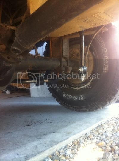

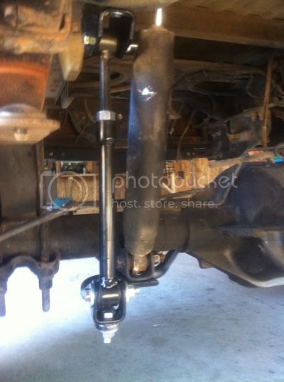

Well its done and works fantastic .
And the street queen comment .. LOL
This is a off-road hunting beast .
So scrapped the links that are OEM and put on 14-16 inch adjustable links .
Had to fab up top brackets but came out great .
Took 4 hrs ... but no more rear wiggle and sway .

Besides a burn in my armpit area it went well .
Drilling the mounting pockets and being directly under falling ass hot metal shavings is not cool .

I don't believe any 2G Reg Cabs came with sway bars from the factory.
My '99 had holes for the rear sway bar, and my '00 had one.
I'm looking to make disconnects for my rear bar. It's great on the road, but it made the off pavement travel considerably more harsh. Not a fan.
Those end links are BEEFY! Holy Crap!
