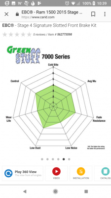

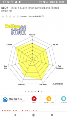

Anybody able to provide any reasoning not to use EBC yellow or orange over greenstuff 7000 series? Both seem to be better than green and Yellow looks to sacrifice wear life a bit for lower noise and orange Vice versa. Orange seems to state track use only? Screenshot_20180529-223927.png Screenshot_20180529-223952.png Screenshot_20180529-223859.png

They're awesome brakes and allow alot of options to give you some trade offs as you can see from the graphs. They even have more options than those 3. But if you are budget conscious, I don't think you can beat powerstop imo.

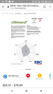

Brake dust is a big consideration for me because I like to keep my wheels clean and usually why I'll spend more. The ultimatmax are considered oem replacement. I put the graph below so you can compare to the ones I posted. The best brakes I've had for dust are akebono full ceramic, but they didn't last long and the stopping power wasn't the best, although better than stock. It's all a trade-off sort of deal. Ceramic tends to offer less dust, quieter, and dissipates heat better. Metallic creates more dust, but has more bite, which typically translates to more stopping power, dust, louder, and more wear on rotors. That's why you tend to see mixes of ceramic and semi metallic. I've even had brakes that were carbon fiber/semi metallic, can't remember from where, but those were dusty.Screenshot_20180531-083953.png

I'm actually leaning towards the yellow over orange for lower noise with the sacrafice of pad life. They're also $100 cheaper for pad and rotors. The orange seem to be marketed towards heavy duty towing, which I don't do. Curious to know any experience between the two or why you wouldn't want to perhaps chose one of the options.
