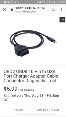

might be worth trying to that price

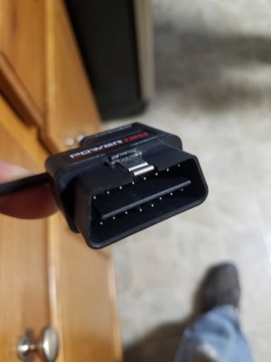

Wouldn't we need the Male OBD2 port connector rather than the Female version?
Georgiasport, please confirm which style is on the cable Edge sent you.
Thanks,
Allen

Doing some more digging it looks like a universal adapter might not work depending on the controller being used. The PowerTEQ cable looks to be using the Holley CAN interface from the ****** EFI with an OBD2 plug from PowerTEQ instead of the EFI plug. I downloaded the ****** EFI packages to take a look at the driver and see if I can find an interface that might work.
https://www.holley.com/products/fue...i/sniper_efi_service_components/parts/558-443
Edit:
I was not fruitful. Looks like Holley is using the winusb drivers in windows with a device ID specific to them. Without dissecting the cable there's no real way to know what it really is and even if so an aftermarket controller would need to be flashed or a modded Holley EFI driver loaded for Ignition to drive it.
https://docs.microsoft.com/en-us/wi...c-installation-of--winusb-without-an-inf-file
The only thing I was able to confirm is that Ignition installs the same Holley Driver as the ****** EFI package so I'd say with 99% confidence its the same controller tied into one of the can lines via the OBD2 connector.

Thanks for the info. Awfully tempting to spend the $16 for the Ebay option & give it a go but not trying to brick my Pulsar w/ the wrong cable.
