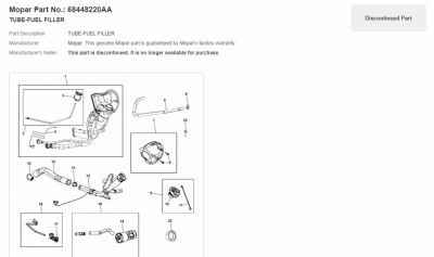

So that last part number - 68448220AA - is listed as a "discontinued part" already. WTF?
buddy guy
May 22, 2019
2,559
2,116
alberta
maybe they have come up with another part design to try like has happened with other parts.
