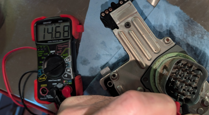

I'm installing a CHR145 and the Sonnax instruction show the pin layout of the WHITE connector. I get nothing on pins 10 & 7 (overdrive). Just want to confirm that those are the same pins on the Grey.
Edited to avoid confusion:
I currently have a grey one. I'm trying to diagnose it.

Yup understood. Not quite what I'm asking though. Trying to figure out if mine (a grey one) is actually bad first.

"In 2009 Dodge eliminated the overdrive solenoid along with other changes"
So that seems to suggest why I'm not getting any resistance on pins 10 & 7.
I'm getting 14,000 ohms on the TOT sensor so I guess the things shot regardless.
