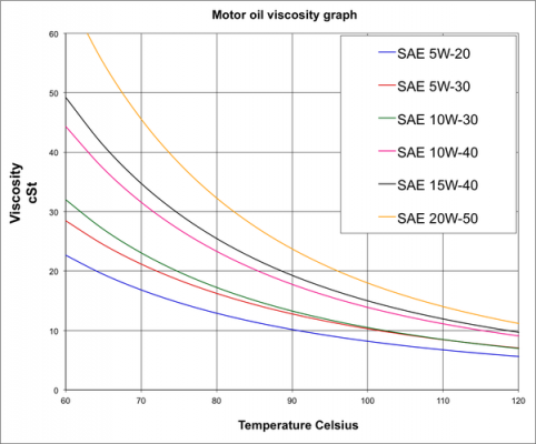

You don't want to operate at the temps permanent, as you see continuous ranges below, but going up a hill you can expect it. Furthermore, the risk is thinning of the oil, it would take a lot for oil degradation past shearing some viscosity which isn't a terrible deal. Even if you were 230f a shorter oil change interval would likely be all you need. Now, the thing is if it gets hotter then that, like 250f, then see below info for an option. Most oils are the top line below (mineral oil), if you are worried then a high performance oil like redline 5w30 is lines 2 and 5 below (pao/esters), so that oil is barely getting warmed up at 230f. You see the green range, that is continuous use w/o the heat degrading the base oil.

i"ve posted this so many times, I can't believe I didnt post it here, just for general info and why it is so important to avoid hot oil. Viscosity is simply a measurement of a fluid versus a given temp, so we understand 5w20 is about 9 cSt operating viscosity and 5w30 is about 12, but that is only at 212f engine temps, in the extremes hot or cold those viscosities are vastly different. So at 120c which is close to 250f, you see what those same viscosities would be... So look at the viscosity of even 5w30 at that 250, it is no longer viscosity 12, more like 7, so thinner then even 5w20 at operating temps, and the hotter you get the thinner the oil gets nothing you can do about it. Trucks that tow should be minimum 5w30 imo, I would leave 5w20 on the shelf personally.
