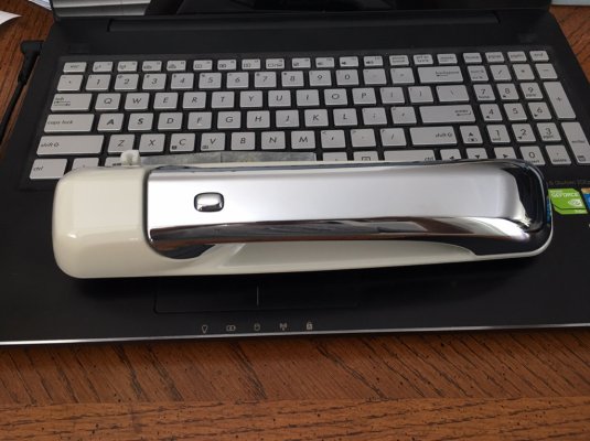

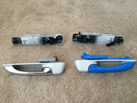

Got everything installed. FOB programmed and truck starting. However, none of my antennas are showing and detecting the FOB in the truck. Passive 1 is showing an open short, so I have some troubleshooting to do. Ran out of time and daylight. I'm pretty certain it has to do with the C2 plug. Getting the pins in was a project, the ends were crimped too wide and did not slide and lock in very well into the connector. I have another C2, so I am going to replace the pins and ensure better connectivity. Unfortunately that won't be until next week.
