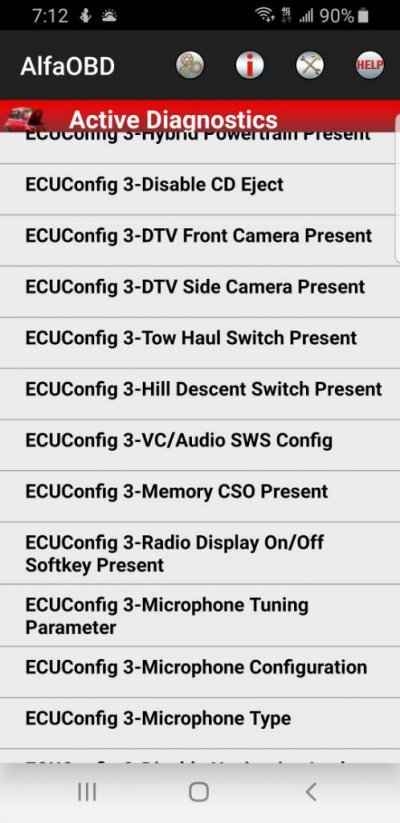

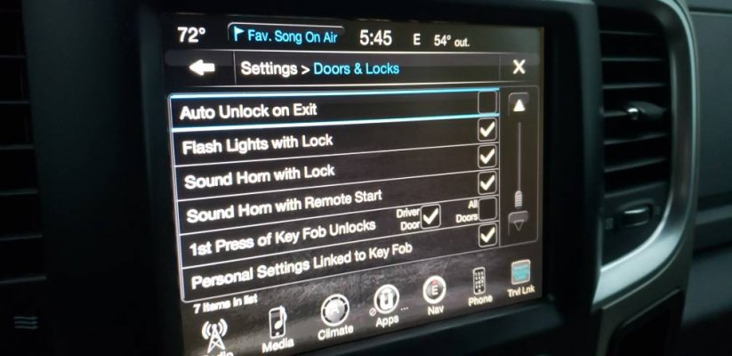

Yes I have the setting on the radio and it will stay checked but the fob won't program to the memory. I found another memory code last night that I set already but I guess it still shows not set . It's in ECU config #3. I'm gonna set it today and see what happens. c5945b8ba45785fd2d8127f16c7e905c.jpg0f14012105ebca3cdfda8aa9b9be7b1c.jpg
The setting I am missing shows up for you in alpha which really has me confused. I have the same other settings under ECUConfig3 but not "ECUConfig 3 -Memory CSO"

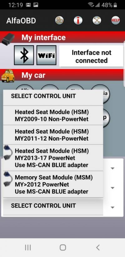

How do I get into the memory seat module in alpha? Is it under Driver's Seat>Heated Seat Module? OR?
Driver's seat then memory module. You will need to Scantool OBD connector or equivalent to connect to the seat module.

I just went and checked and the Ecu config#3 memory CSO setting is only available on the 2014 and 2015 trucks with the alfa tool. Deffinently strange but not sure if that's what's causing the issues.
Well that explains why I do not see the setting. But brings up a couple of questions:
1) For 2016 and newer Rams there are only 2 settings for memory to set then?
2) Wonder what year Ram Oldfarmer has since he got the memory to work, if its 2016 or newer he could answer the first question

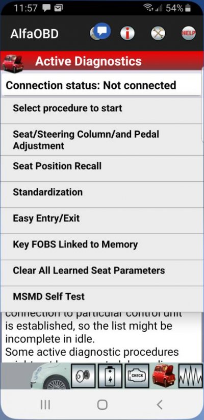

Franklin....thanks for your answers. The CANBUS connection is good since I now have Easy Exit and did not before adding the 4 wires. To clear the codes in the msm do I go to "Driver's Seat">Memory Seat Module and then to?
Once connected to the MSM, go to the Engine icon on the bottom of the app. You can read and clear any faults there.
Well, no joy.......cleared all faults, performed the Standardization test, and cleared all seat parameters. No difference. I will wait a bit to pull the door panel since I have new ones on the way. Just might as well wait till the new door panels are here and then take a look at the wiring going to the door module.
