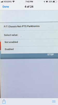

Has anyone ever ran into the problem of no volume after the install? Everything else seems to work just no volume I've checked all the settings did I miss turn something on bcm?

Did you Enable the csm for Volume and is checked on in the radio settings ?

So you should have
Park assist type rear or front/rear is doing both front and rear
PTS configuration
Ultrasonics
PTS
Then the park assist volume csm rear
Then park assist volume front if you did the front as well

I did the rear only
PTS configuration
Ultrasonics
park assist volume rear
YOU HAVE PTS I don't recall a setting that said only PTS!!! Do you happen to know where in alfa it under?

Still no sound will have to retrace all my steps tomorrow im missing something!! thanks again for your help

Started my truck this morning everything worked including the sound. I'm guessing one of the modules in the bcm just hadn't updated. THANK YOU AGAIN!!!! Your help was most valuable!!!!
