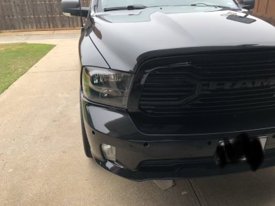

My front harness is ready to go this is the end I had to cut off of the factory bumper harness didn't know the part# for the connector.
