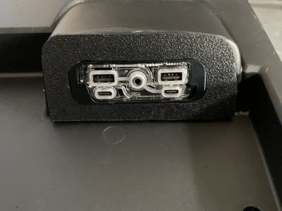

That's awesome. Do you have any pics on your process/progress? I'm trying to find someone that can help me with a 3d model.
Kyomie
Aug 8, 2019
24
NC
Here is my progress on the USB port with USB-C. Everything is working as it should. I added black screens to secure everything together.
