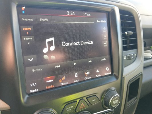

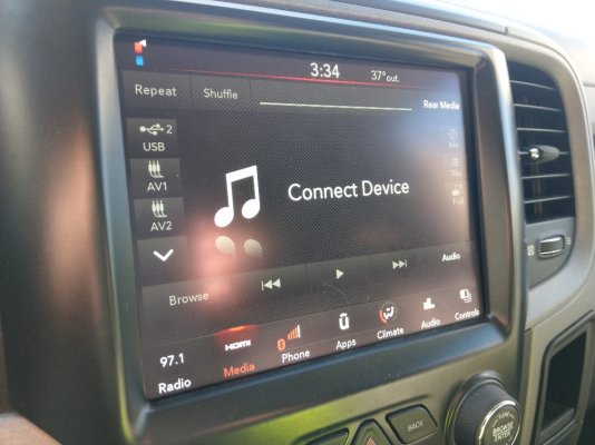

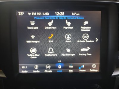

FYI greyed out icons such as heated seats etc is only because the engine is not running. All functions work as they should, just trying to figure out the camera's app buttons not appearing to be able to drag down into my main bar as I had with a ra4 nav 8.4 before this UAQ.

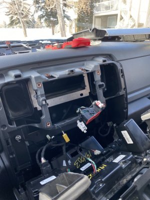

Finished installing my new 2018 unit into my 2017 Ram, plug and play so far, I have to install the new media hub on Monday, I’ll let it sleep for a bit

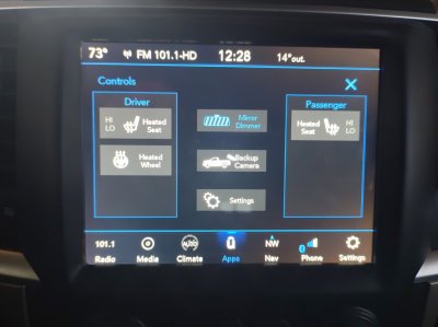

I can pretty much guarantee you that the Radio & Connectivity Trailer Hitch Camera is not set to “Yes” on your 2015.
@PdPuNOme
This is definitely the setting to get the back up camera, both in the Control screen and in the app section. I changed my '15 yesterday and the third drive cycle today they both popped up. Now if there is a way to stop the camera from dropping out when you go over about 10 mph.Control Screen.jpg AppMenu.jpg

I'm presently trying to figure out the video in motion now. I'm not sure if I'm making progress, but I'm making something...I finally got the extra inputs to appear.

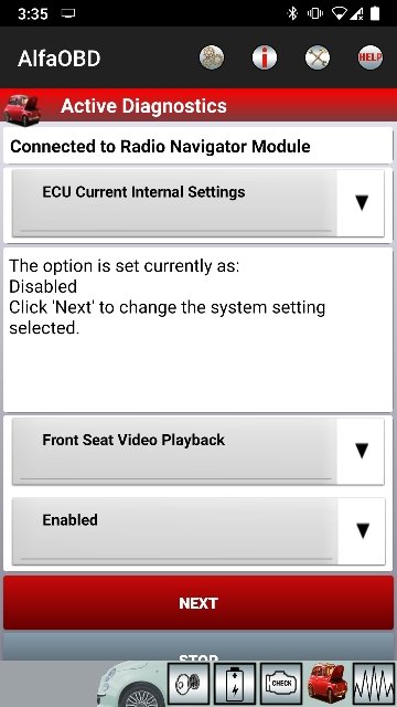

The back up camera button works but as soon I go over about 10 mph the screen goes blue. Most likely the power is being turned off to the camera, but that was sorta already known about '15. I might have to isolate the camera power and feed it with switched ignition power provided the tailgate camera won't be destroyed being powered up most of the time.
There's an explicit setting for it in the radio settings for AlfaOBD too under internal ECU config but when I change it it reverts to disabled...64f3b9d57e747e08af1726c3e281ce20.jpg
