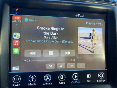

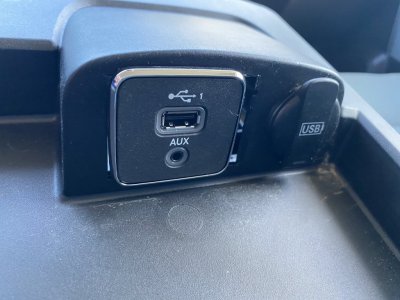

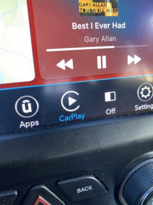

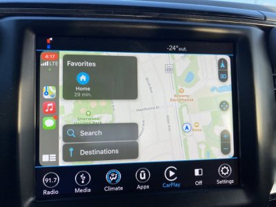

Completed my CarPlay set up on my 2017 RAM 1500, installed the radio a few days back, just needed to finish the USB port. The new port seems to slide out, I may have to glue it in place. Does anyone know how to wirelessly connect to CarPlay without a cord? I’ve heard of a dongle?
Nice setup. Im not sure about a wireless carplay dongle, from what Ive read some work but can be made to no longer work when there are iOS updates to carplay.
