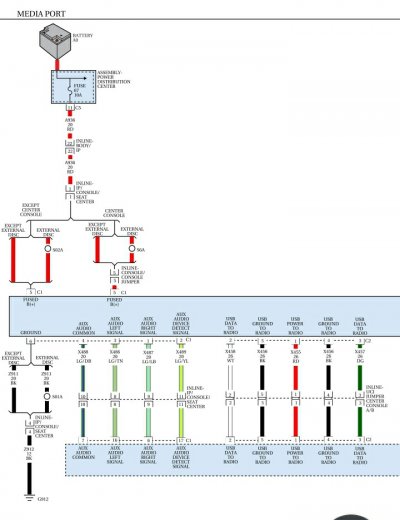

I did a little more testing on my radio hub and found that on the Chrysler 300 media hub, the aux input is recognized but not the usb. Same goes for my original 2016 Ram usb hub. I tested using two different apple lightning cables.
Im just unsure if its an issue with the radio, the wiring harness or the hubs.

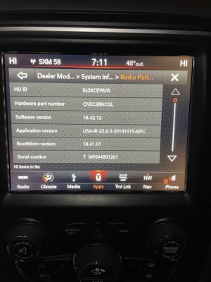

What's your firmware level? I'm having the same issue on a UAQ I just installed which was manufactured in 2017.

You're on Application version 22.6
I'm not sure if that hardware PN reported but the radio is an actual ram UAQ PN for MOPAR PN 68331631Ax (can't recall exactly).

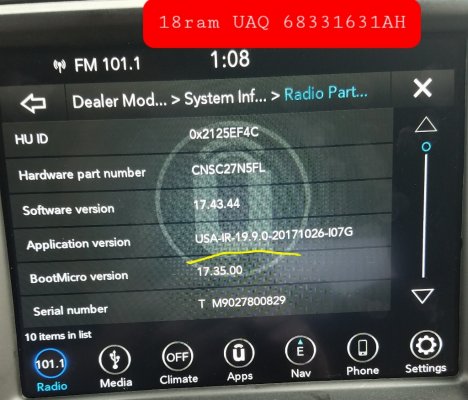

Edit: found this picture from another post of mine , post 2420 (caution about franken radios), for the new 2018 UAQ 68331631AH I bought from AllMoparParts previously in my last truck (before the v22.6 update) ...8e74863744db97bee8bb53abc6d5e1db.jpg

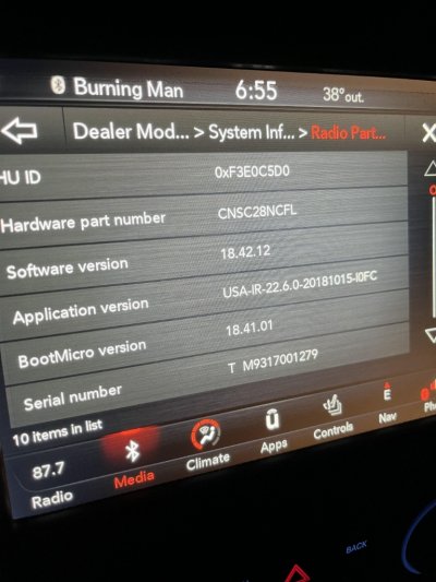

I thought I’d add mine too for comparison.
Part 68331631AJ. I’ve had absolutely no issues replacing my RA3 with this almost a year ago.

They must have updated the internal HW PN.
The aux is hardwired though the usb hub/power adapter harness (where did you get it? Deereguy's KaodTech site?).
Keep in mind, that there is a dedicated grey USB cable (mini USB) that has to be plugged in/seated fully at both the USB hub and radio. If all that is good, you either have a bad or incompatible USB HUB.
(I did see where someone claimed that Chrysler 200/300 hub will work, but it's not confirmed by anyone else yet)

Yes the adapter harness was from KaodTech. I also double checked the mini usb plug to ensure it was fully seated. It seems my best bet is to try with a different hub. Out of curiosity, should the UAQ radio still be able to pick up the usb input with my old usb hub (2016 ram) and simply not be able to run carplay? When I tested it, it was not able to, not sure if thats to be expected with a newer model year radio or if it indicates something may be wrong with my mini usb wiring harness

Just remembered... There is a dedicated usb hub fuse that needs checked... Can't remember which one off hand
Edit. Fuse f67
& The mini usb cable passes though a 2nd inline connector under the driver seat (, or front of the console) on the way back to the radio.

Thank you so much for this info. I'm going to take a look at the fuse box tomorrow. Hoping it's a quick fix, if not I'm going to go with a compass usb hub and see if I can get better luck

I gave a quick check to my fuse box and found fuse f67 is still good. I ordered a cherokee usb hub 5XG28DX9AD and I'm hoping that will be the fix I need, short of that not really sure what else could be the issue.
