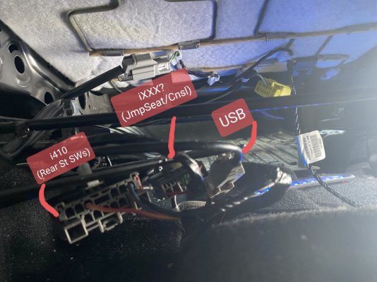

I gave a quick check to my fuse box and found fuse f67 is still good. I ordered a cherokee usb hub 5XG28DX9AD and I'm hoping that will be the fix I need, short of that not really sure what else could be the issue.
I just fiddled with the wires going into the harness under the driver's seat and it started working again. You may want to check that too...

Will do, is the harness running the console hub the grey plug harness on the right side underneath the driver's seat?

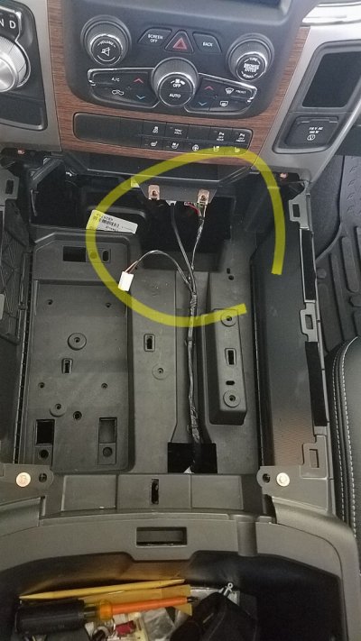

Do you have a center jumpseat or full console?
For a jumpseat, the usb connector/hub wiring passes under the drivers seat ...
For a center console it's at the front of the console beneath the radio/dash...
M² Mods.
I have a full console. Thanks for the picture & description, I was looking at the i410 harness thinking that was the one, if its the same for the center console the USB one looks pretty distinctly different
