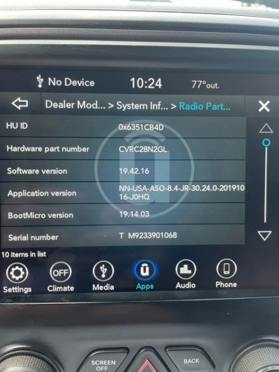

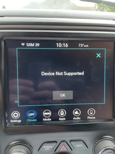

So just installed a UAS radio for my 2018 3500 Tradesman, all went well but the buttons on the bezel aren't working except for the hazard lights. I took apart and reconnected everything and still nothing. Maybe I got a bad bezel from ebay? Issue is that I do not have steering wheel volume controls so I kind of need the bezel to work lol.
Also, when I first installed radio the back up camera and XM came up. After reconnecting everything to try and get bezel to work now I don't have back up camera or XM. There's also nothing in the settings for the back up camera or all of the other custom setting for the truck (locking/ engine off etc). Anyone else deal with this? Not sure of what to do.
I installed the radio from https://www.ramforum.com/threads/sold.181565/
At first I was getting device not supported error and thought it was because I had USB plugged in but then it went away and now it's back. I have attached pic of error and software from dealer mode if anyone has any suggestions.
View attachment 472524View attachment 472525
SXM and camera will appear with time/power cycles. Did you buy an 8.4 conversion harness to get the bezel to work? If not you can buy one from forum vendor @Mpgrimm2 . Do you have any USB devices plugged in?
I got the harness from Mpgrimm2 and installed as per his directions. I have unplugged everything a few times so maybe the system needs a few cycles like you said (disconnecting the battery every time). At the moment I do not have any USB plugged in and I have figured out that if the truck was turned off with bluetooth connected that error comes up when starting, doesn't come up if I turn off truck in AM/FM.
Starting to think the bezel is a dud since the hazard button works but nothing else.
Edit: worked with Mpgrimm and looks like it's the bezel, just ordered another one so hopefully that does the trick. It's usable but just don't have volume control at the moment lol.
Good stuff, its interesting about you getting that error with Bluetooth. You might have the same symptom as forum member @Earl Zeis

Mpgrimm said the error is normal with the newer software. It’s nothing that effects performance. I just click ok and it goes away
Normal somewhat. I think "common" is a better description. For me, I was able to eliminate it by turning off USB debugging in Android settings but mine occurred with USB connection. I wonder if there is a similar setting you could try? Are you using an Android device for Bluetooth?
Common might of been what he said lol. I have iPhone so there's no debugging that I know of. I haven't had much of a chance to really mess with everything yet so I'll report back when I do to see if I can get rid of it.
Even more interesting. I'm not as familiar with IOS but I wonder if there is some kind of Bluetooth setting that is user accessible? Does IOS let you modify Bluetooth version used?
That maybe so but when you spend all that time and money to get an error message everytime you start the truck, it's leaves a bad taste. Especially when someone else in the tuck asks about it. I had the ***** of it the first day. Unfortunately there is no software updates yet. Hopefully the next update solves it. But been waiting for an update since spring.
Earl
Does yours do it if you turn off Bluetooth on your phone?

Humor me...
It does it with no Bluetooth, no USB connection. Phones no where near the truck. Phones paired or not. Like I said, it's not a phone issue, Android or Apple. The only way I can get it to go away is to unplug the hub. It's done it since I first powered it up. Brand new UAQ from Ram for Ram with 34.2 software. Radio manufacturer date of March 2021. 68331631AL. Installed April of 2021. 68328704AD hub. That's as much as I can humor you.
Earl
Unfortunately, v22.6 was the last publicly released version for Ram, but I've seen sw update on UAQ's from customers that got their radio repaired by United Radio with v39.6 without any issues.
The closest newer version to that I've seen shared is in @ClearlyStabile 's Alternative Fw thread which has v39.5 you could try (at your own risk) or possibly the Chrysler 200 Style Dual USB Hub linked in post 5 which may work better on that fw.
