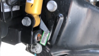

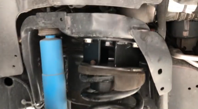

OP, check your front shocks and see if you have the shock extension at the bottom ? like this
you prob have the 2.5" spacer at the top of your front springs

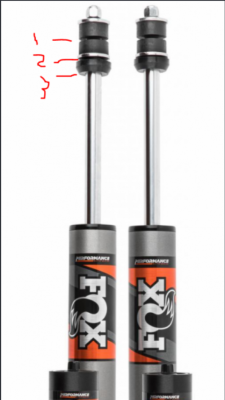

Do you still have your factory front shocks ? if so, measure from the top (#2 in the pic) until the center eyelet at the bottom, that will give us your max extended measurement on the stock ones
Also what is the part# for the N3 shocks you bought ?

I think i found the front stock shock length on a 2019 2500. Should be 21.9 extended, 14.3 compressed.
The RC kit included those shock extenders at the bottom cause they assume people will keep factory shocks with those. If you got longer shocks your shop should have discarded the shock extensions. so we need to know what shocks you got from RC and whether or not you're using the RC shock extension. You just need a little longer shock and no extension at least to improve over what you have then later on you can decided what else to do.
Also If you need an adjustable trackbar (measure the distance from your frame to the edge of the tires on both sides. that'll indicate if you need to re-center your front axel.
