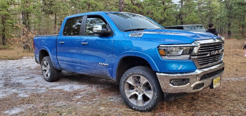

Crap....now I regret in ordering RC leveling struts for my 1500. Has anybody have both for comparison?
I used to have the 5100 on my old 2012 ram 1500. Good shocks but just a big too stiff for me. My charger has bilsteins and I'm just looking for a softer ride...but with a 2.5" lift. Did I make a mistake?
