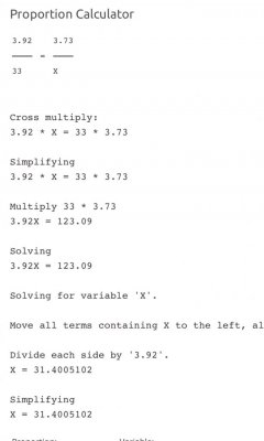

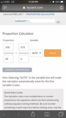

*How is anyone getting upsize +1 or 2 to gear-up? IMHO Skip the tire size calculator for simple things. Just use high school algebra math, Means and Extremes. Free calculator via https://www.wyzant.com/resources/lessons/math/algebra/calculators/proportion
Say for example on my 1500 w 3.55’s, the factory tire size is basically a 33”. If I wanted to calculate for tire size change to gear-down to a 3.92 I do the following...

I’m still not seeing the solution being a +2, I’m seeing -2?? O/P wants to gear-up to 3.73’s, not gear-down. *Assuming you have a tire ratio w a p-metric conversion equaling 33’s. Here’s using OP’s ratio numbers with an assumed tire size and even then it shows as a downsize even if I switch the tire size to a 35”.
Assuming 33’s equates to dropping to 31’s.
Assuming 35’s equates to dropping to 33’s.
