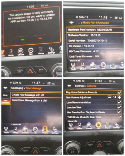

Well folks, my truck is a 2013 SLT and I have successfully updated my
2014 RA4/Vp4-NA (My14 pn:68224525AH)
from 15.26.1 to 16.13.13
Using the 2013-2014 fw uploaded to my RA4 FW Info thread.
- 12 units (files) were updated.
EDIT: Video accidentally deleted. FML
- Text messaging voice dictation still works (vs canned responses)
- Turn by Turn Nav in instrument panel/Evic option still available in settings menu.
- can't confirm Siri Handsfree since I don't have an iPhone (but I can get one if some one knows how to verify Siri Handsfree)
Note:
Member, Ricks Ram, lost the middle 2 features above when updating the fw to 15.26.1 using the official NA Maps Update thumbdrive he purchased for one of his 2014 RA4's.
Not sure if this is due to his truck being an Express vs my SLT trim level or if it's due to the "minimal/partial" fw file included with the map update.
(15.26.1 is apparently the minimum Fw for the 2013Q4 maps)
