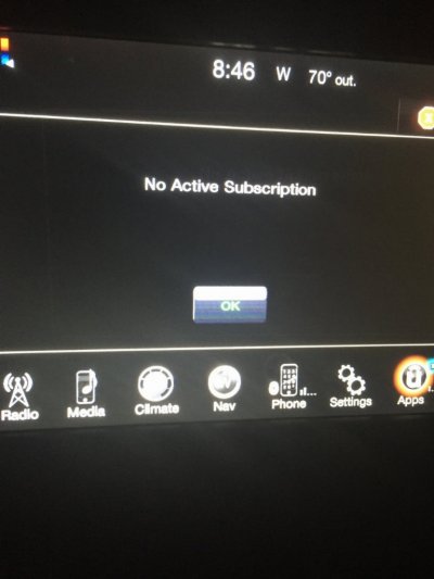

App links and initializes then it says this ....1ba79df64cb2d0c63113d9034777ec8b.jpg
Guy at nav repair did mention to me that apps won't work unless you have uconnect....
LOL. I get this same error message when I attempted a couple of time to get those apps working. My 8.4 is stock that came with the truck .

Interesting. I'm assuming you don't have uconnect subscribed. That would verify what navrepair said. They said those apps are associated /verified with uconnect.

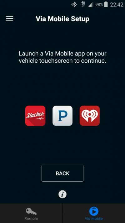

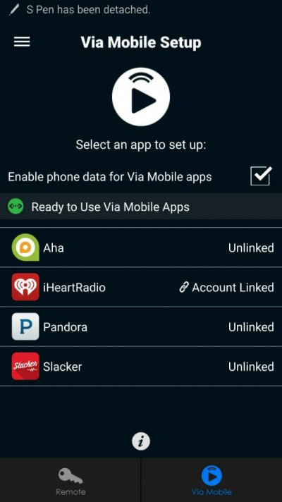

You have to;
1. Go on at least one of the 4 apps websites an create a free account.
2. Download the uconnect app to your phone which it sounds like you already did.
3. Launch the app on your phone, while in your truck.
4. You then select via mobile apps and they will show as unlinked.
5. Select the app you signed up for an link it
6. Launch that app on the radio
Limeybastard
Jul 25, 2015
1,872
451
Shady Hills, Rednecksville Boro, Florida.

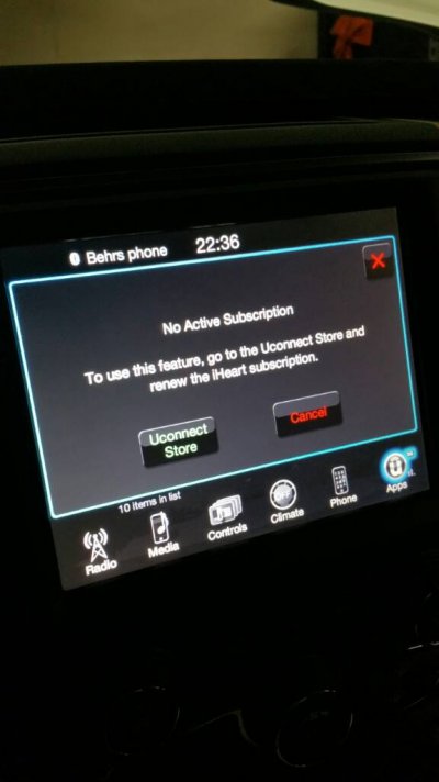

Just loops, can't get it to to control iheart radio via the 8.4 sceen. App store says trial is included, when I attempt run app it says I need to renew my iheart subscription. Etc etc. Even thought iheart is logged in under my details and running on phone.
Sent from my SM-N910T using Tapatalk
cptwing
Aug 14, 2014
1,446
497
The Soviet State of Connecticut
2014 3500 ST DRW REG CAB
6.4l Hemi

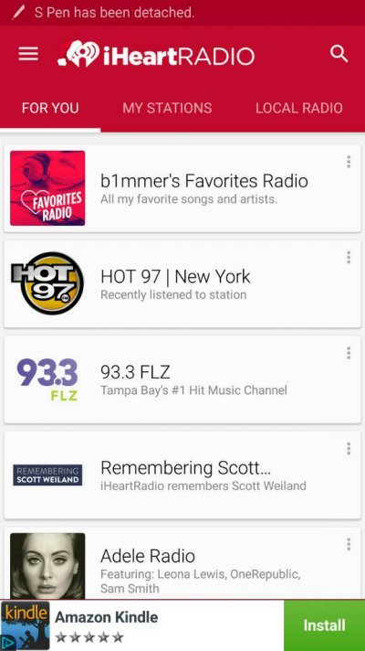

You are not supposed to launch iheart on the phone, don't even open the iheart app. Just open the uconnect app on your phone and make sure you have iheart linked and that the status icon is green and says ready to use on the uconnect app on your phone like the picture I posted, then launch the iheart app on the radio.

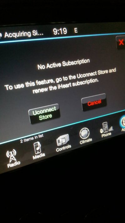

Now I am very sure useless connect did something I no longer can use YELP either. When I try I get the same message, "no active subscription go to the uconnect store etc". Is anyone else still able to use yelp?
I'm sure they will never tell exactly what they did, but I think based on what Limey had to do that they sent out a push over the cellular network. In that push they added a subroutine to the software that requires your radio to authenticate on their server to use the via mobile or Yelp apps. The server will then reject all current radios that do not have the latest app. Then you need to go to the uconnect store and re-download the app containing the required authentication.
I'm guessing the only way to get it working is to pay, and even that might not be an option. I know the "free trial" for apps is supposed to be 5 years, but that account gets deleted when the radio is initialized with a new VIN.
