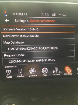

Isn't 13.44 the an older version of software for your 2015 radio?

Not sure vin matches a 15 but not sure about updates etc...junkyard could have given me bogus info. Not sure

I think that might be the infamous Jeep firmware/radio. Try and update with a 15 VIN and then a 14 Ram. If neither work, stop and return it! Dont try and update it anymore or itll brick it.

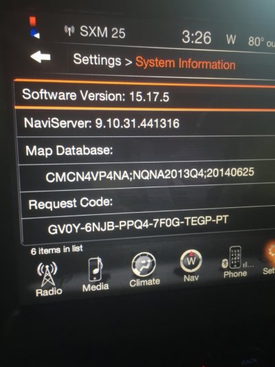

Well I had a real roller coaster ride this week guys. First I tryed to update from software quoted above. The suggested download based on vin was incompatible so then I installed a 14 update. That worked except for step 11 which is xm and I lost navigation. I ordered a second 2015 unit lol. It arrived and screen was cracked. I said screw it went to nav repair. He told me the unit quoted above was definitely a 15 and that it's not the radio but software. He said that modders as well as paying customers have problems with some these updates...anyways left unit and 3 hrs later he called and said ready. I now have 15.17.5 with Pandora, slacker etc (although I don't think they will work).

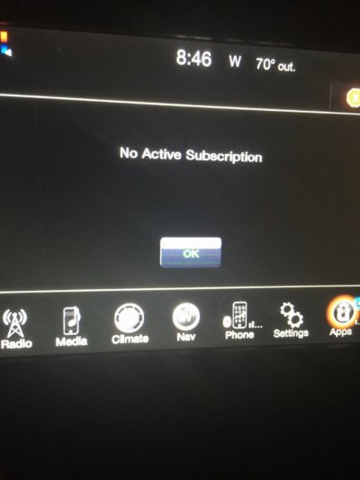

Do you have all 4 of the via mobile apps? Slacker, Pandora, Aha and Iheart? On mine I have and they did work until just recently. Now I get a message "No active subscription, please go to the uconnect store and re activate your account". Kind of bummed and confused, its a 2015 radio and the via mobile apps have a 5 year free trial, so how could it run out, weird?
Anyway very curious if you have all 4 and if they work.
They are easy to use just install the uconnect app on your phone and link your respective account for they app. Please let us know?

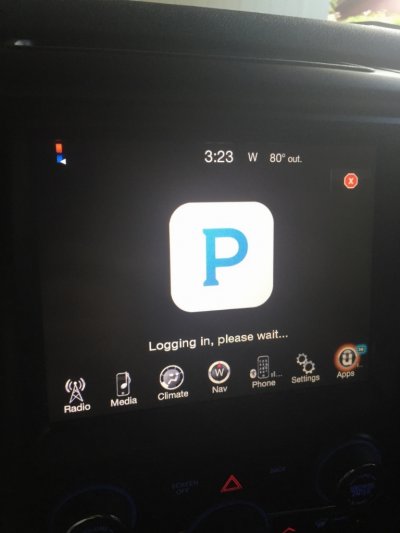

App links and initializes then it says this ....1ba79df64cb2d0c63113d9034777ec8b.jpg
Guy at nav repair did mention to me that apps won't work unless you have uconnect....

Maybe to some, personally I really liked Slacker and Pandora, it never cut out like XM does because of clouds bridges or trees. Its weird all of a sudden I get that same message Hanksram is getting. I am wondering if useless connect did something since their is no way the 5 year free trial could be up. that is the one for Pandora, the Slacker one is a bit more specific and talks about going to the uconnect store.
I will say even the sound quality on the via mobile apps was slightly better as well.
