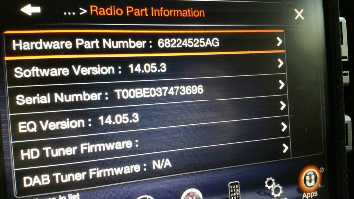

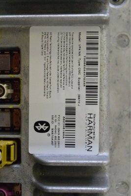

Good news. I found the serial number. I got the code. I had to use engineering mode to get into the radio to find the serial number
That is nearly the same radio part number Jared 4.7 has and he updated to the latest fw. But who knows.
2014 Ram 8.4AN
68224525AB
14.25.5>15.26.1
Zero problems since original install and recent update.
Thanks for posting pictures of that engineering screen with the part number.
To others, please share your radio year & PN:
If you press and hold both the temperature-up (red arrow) and temperature-down (blue arrow) buttons at the same time, for 5 or so seconds, you are presented with the "Engineering Menu"
Sent from my LG G4 on Tapatalk.
