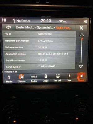

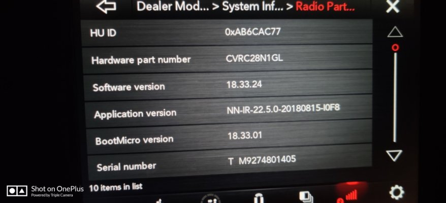

You should be able to get the part number from the System Information screen. I doubt it would be different than the one on the label.
Hugearse69
Sep 26, 2018
20
Utah
2019 Big Horn
Hemi 5.7L with E-Torque
True. im starting to wonder if its not from a 2015 even though that's what the part number has lead me to believe. Still wouldn't explain why the update screen wont come up at all. I wish there was a way to force the radio into update mode. Is there any way to update from the SD card slot?
