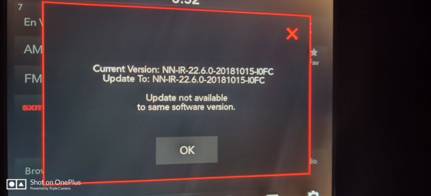

I tried update to 22.6 from post #8 to my 2019 Ram 1500 Classic says not compatible
Sent from my GM1915 using Tapatalk
Kenepo17ram
Oct 28, 2019
144
35
Brooksville, FL

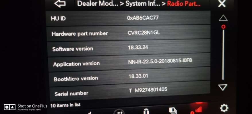

Ooopss apparently i downloaded the wrong file, but was able to upgrade to 22.6 fw, letting it sleep cycle and go check. Previous FW was 22.5 as seen in the pic, upgraded to 22.6 as seen in the pic.ab718e172335270cede3424a6c2d84b0.jpga9b40531f1bbf291c7ad6585ff3c63c8.jpg

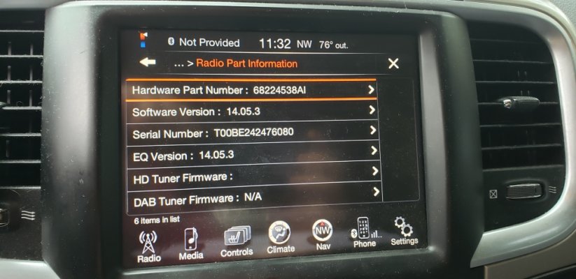

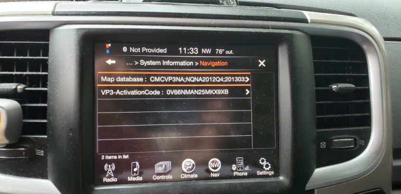

Hello, new here so forgive me if I missed something. 2014 SLT originally from Canada. Has a RA3 VP3 without nav.
P/N 68224538AE
Running 14.05.3 I have searched everywhere and cannot find update files for it. Would like to try loading US version?
on a side note: Its hard to believe that this cant be hacked for the Nav abilities. $600 to activate is quite a scam.

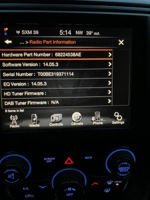

No luck for mine, Tries to go to media and says cannot read usb or something similar to that lol. What version did you upgrade from? Not that it matters as I haven't found any of them for this one and UConnect's site says mine (with 14.05.3) is current.

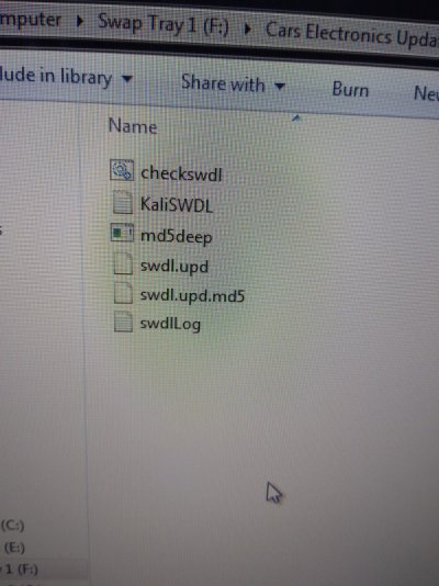

There should be 6 files onbthe usb drive. Not in any folders, and there should be no additional folders. Ill post back with a pic in a minute.
The files should be extracted from the .zip file, and then saved on the drive like this:
But, if your already running 14.05, i dont think id bother changing it.

It's only giving me 5 files from the zip missing the last one ( swdlLog ). I'm guessing maybe I need to be at 17.something before it will read it? Wouldn't 17.0 or 18.0 be better than 14.05 ?
Yes you will want to go to a 17.x version first.
17.11.07 or 17.43.01.
Do you have a radio that came from the factory with navigation (RA4) or one that you paid for a code to activate navigation (RA3)?
BTW the 6th file is the log generated during update, so you wont have it on your USB after extracting the update zip.
For now concentrate on getting to a 17.x version, if we know what radio you have we can point you at the correct file.
