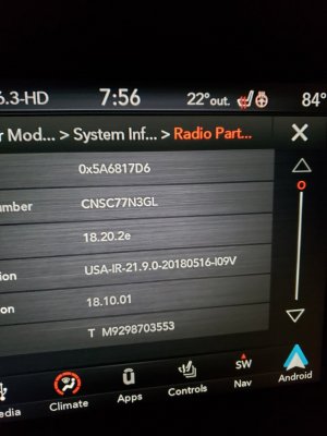

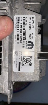

Anyone know if there is a software update for this radio? I don't have the vin this radio came out of

What's the year/model/PN of the radio?

Yep, that 68306656AN is the pn.
Not sure what year/model that came out of but it's not a Ram UAQ radio so you will need to figure out the year/ model vehicle it came out of (18 Jeep Cherokee?) and then find the vin of a same year/model that came with the UAQ 4c Nav radio. . . Them use that vin to check for updates at the uConnect site... There is likely an update to application v22.6 but you may have to take the vin into a dealer service advisor to get them to put it on USB if the uConnect site doesn't show one (tech. will have to download it).

Thanks will try care if the VIN is from a different vehicle?

My Vin in my truck is different from the VIN I am going to bring them. Will they care?
You need the VIN of the vehicle it came out of or the VIN of same year/model vehicle with the same radio

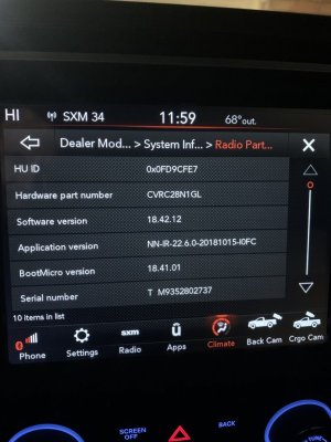

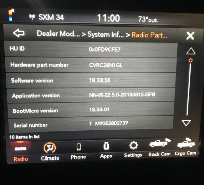

I have a 2016 w/RA4 & Alpine that I upgraded to an UAs out of a 2019 Classic. The radio came with 22.5 installed. I used the donor vin to check for an update and it came back with none available. I was experiencing intermittent zero volume from going from the radio to a phone call on CarPlay to back to radio. I would have to change inputs several times to get it back. I flashed 22.6 from post 8 anyway and was successful. I can verify that even though it is listed for a MY18 it will work on a 19 Classic. CarPlay seems to actually be a little smoother and it sounds like the audio sounds better in general, but it could just be me.
