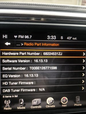

You definitely DO NOT have a 2013 RA3 VP3-NA radio...
Your radio PN is 68224531Ax which appears to be a 2015 RA3 VP3-NA according to post 9.
Go back to POST 9 and download the 2015 file that matches the first 8 digits of your pn and see if it's accepted by the radio.
(Online search for that PN comes back as 2014 ram RA3 VP3-NA >> might be a typo in post 9 * , but the file is definitely a MY_15 RA3 VP3-NA file)
NOTE
* I thought all 6822xxxxAx PNs were 2014, but I likely got that PN info and file from another member that used it on his truck, it should be correct.* (I don't follow the RA3's & Canadian stuff closely).
If the file doesn't work, you will need the VIN of a 2014 ram Bighorn or Laramie that came from the factory with an RA3 VP3-NA radio, and take the vin and blank USB to a dealer to get the 17.43.x file (please share here if you do).

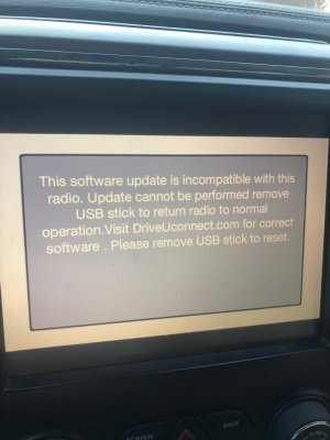

Yes, Tried the file, still not compatable.
Then it must be a typo in Post 9 and you definitely have a 2014 RA3/VP3-NA as I suspected for that PN. You will need to source a 2014 USA VIN with an RA3/VP3 3C radio and use that to get an update from a dealer or wait for me to get to a dealer and share the file here... Unless someone else has the v17.43.01 they can share
