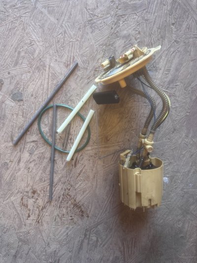

The problem is the fuel sensor/pump. Apparently it's a common issue that SHOULD BE A RECALL! See other thread here: https://www.ramforum.com/threads/fuel-gauge-stopped-working-only-displays-empty.150927/
The problem with my fuel gauge in my 2017 2500 Cummins with 55k miles started a couple weeks ago when it would just drop to empty. I'd fill it up and it would only take maybe 10 gallons. Took it to the dealership and they found the fuel pump completely cracked/separated (see attached). Was in the shop for 2 days and cost $1,030 for parts, labor and gas to repair (no warranty coverage on it). The dealership said if I had let it go another week, I would have had to have the truck towed in. I reported this as a safety issue to the NHTSA at https://www.nhtsa.gov/.
