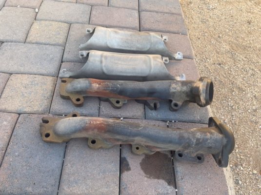

Headers from my truck are available if anyone needs them.
Honestly first $20 plus shipping takes them. I have a box I can use so won’t be an added expense.
I’ll throw in my bolts that didn’t break, but I recommend getting new hardware.
Autozone carries 10.9 bolts: they’re m8-1.25x something longer than 25mm lol.
My new AFe manifold bolts are 25mm and the oem were substantially longer. Prolly 35/40mm.
Sadly, one of the bolt holes twisted off the top heat shield.

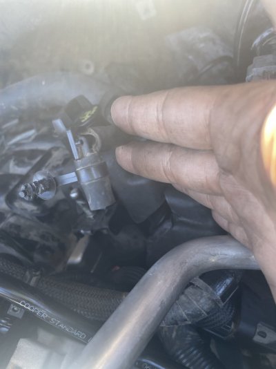

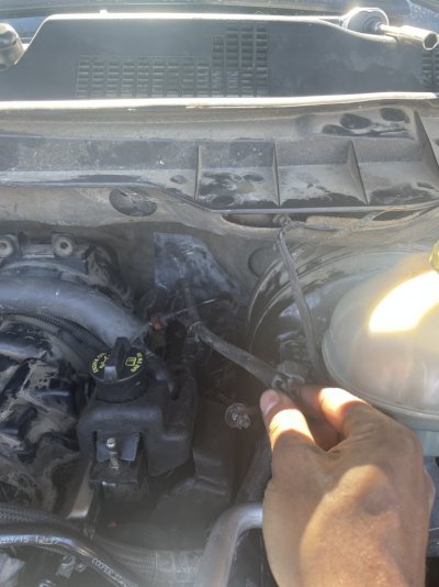

Ok can someone help me figure out where this tube goes has a 90° plastic elbow on the end and I don’t for the life of me remember disconnecting it.
Last thing before start up
If you haven't figured this out yet,odds are it's the transmissions vent line,if it is,the tube/hose should go down to the top of the transmission
