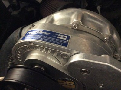

View attachment 218268 I have that D1 blower on my 19 5.7,my past and current issues with procharger usually revolves around belts.But over spinning and cooking the D1? I see a F1c in your future it can handle 14 before belts start shredding.But what did you do with the trans
14lbs I assume you mean? And I haven’t heard of any limitations of the D1 yet. Since I’m getting an Overdriven damper pulley, that will allow a greater surface area upper pulley to be used and not have the belt slip as much.

My vette builder is a procharger dealer and I’ve heard him mentioning how over spinning near 62k results in frequent rebuilds but by the time he’s done explaining all the math other then the 1/2” inlet outlet size difference the D1 and F1c are close .I understand that the extra heat,= less hp Which is why we opted to use a cry02 chiller with a nitrous bottle.At 14 lbs irs a huge difference in IATs.He talked me into twin s/c now as soon as the widebody kit is done and painted. As soon as all this bs is over I’m getting a trans tune for the ram so the Dyno pulls go smoother for the tuner.Also I have Alky **** systems on the vette and one using boost juice on my tuned Audi so the truck is getting one before the final tune so any octane issues won’t matter.
