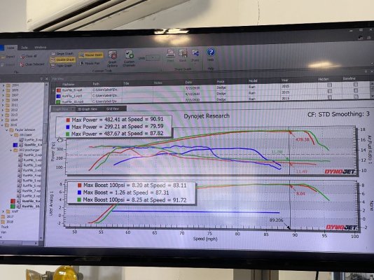

Can you post the dyno sheet? I'm wondering how the power curve looks around the 3800-4200 ish area. I feel like that's where the intake manifold switches runners.

This dyno was definitely very conservative just to ensure everything was done correctly.

Ok mainly I was asking to see how it held up

I have yet to dyno my truck but man that initially AF Ratio tip in scares me. I would like it much closer to 12:1
