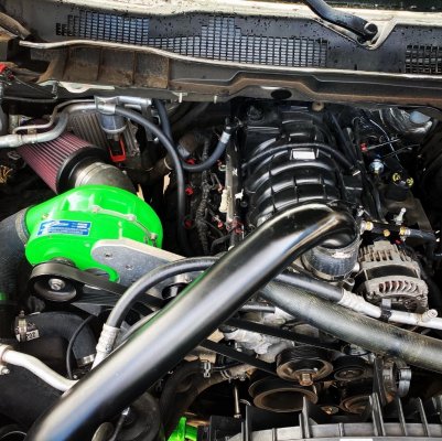

Hello everyone.
I just recently got my truck back from my local shop after getting a D1SC procharger kit installed in my ram 1500. At the moment I am making 490whp with 8lbs boost with a stock lower pulley and 3.35” upper pulley. Soon to come will be an 16% OD lower pulley to up the boost.
-Update 1: Got the 16% OD pulley on and am now making 560whp but still the same boost. A retune will be happing soon.
Current parts list includes:
-CompCams stage 1 master cam kit with MDS delete
-Deatschwerks 1000cc injectors and dual 300 fuel pumps with separate surge tank
-Fore Innovations FC3 fuel pump controller
-Holley fuel regulator
-Kooks long tube 1 7/8” headers Catless
-Melling oil pump
-Modern Muscle Xtreme Forged stop in pistons and rods
-Procharger D1sc kit
-3” Y pipe, to stock dual exhaust.
-SRT4 map sensor
-Innovators West 16% OD pulley
Feel free to ask any questions you may have. Enjoy!

Wow what a amazing build!!!! Congratulations!!! Did you do anything to the 8 speed?
Nothing yet but I do have plans of building it up in the future with southern hot rods kit.

I'm assuming based on the fact you went with new pistons and the really beefed up fuel system that you're really going to push this truck, what's you're end goal for HP? Curious to see how things go! I'm really close to pulling the trigger on drop in forged pistons for peace of mind.

I wouldn't chance F/A on stock pistons. There is zero room for error. Do it once and pick up a set of drop in pistons/rods like you mentioned. If you're goal is more than 650-700whp get yourself a forged OEM 6.1 crank or similar.

dammit why did i click on this thread.... Modifying vehicles like this is my ****!!!
install looks good. i must admit i HATE to Green procharger, but its not my truck, and its what the procharger does that matters lol.
Nice little build though. i would love to build up my 6.4l Hemi like this. but cannot afford it with this truck hahah.
Now post some damn videos of that thing whining like a *****!
