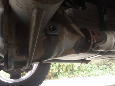

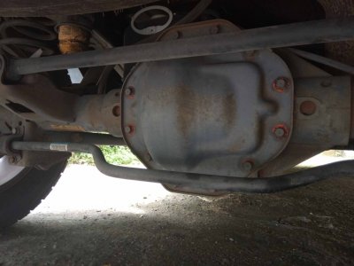

I wanna change my diff oil but I'm not sure if it is a LSD or not. It's a 2WD with a 3.55 axle ratio and when I check with my VIN I find this:
DBA ALL AUTOMATIC TRANSMISSIONS
DG1 6-SPD AUTOMATIC 645RFE TRANSMISSION
DMD 3.55 REAR AXLE RATIO
DRN 245MM REAR AXLE
DS8 CONVENTIONAL DIFFERENTIAL REAR AXLE ----> seems not to be LSD
What do you think guys ?
Which oil I have to use ? 75W140 but I don't need to add the LS additive?

Open, you wont need additive. I don't know if they put lsd on the addon side of the sticker or not, Anyhow, either way lsd or not this oil will work. gl-5 hasn't been updated for many many years, so they don't update oem's because it is still the same oil. You san email Dave at redline, he would give you exact info. That is the oil that I know a lot of guys run in the open diff or lsd, and on specs section is spec'd for Ram.

You have an open diff (mentioned already)
I don't believe the friction additive is required in the anti spin (LSD) since it is a helical style rather than having clutches- so don't sweat it.
Open to correction if I am wrong.
The OP has a 1500, they have clutch type LSD from the factory. The Helical gear style LSD are on the HD trucks.
Any of the good synthetic axle gear lubes are available with the friction modifier already added and it doesn't hurt anything to run it in open or gear type differentials.
