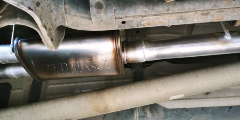

I got flowmaster's flow FX on mine single 3" inlet dual 2 1/2 outlet like mine pretty well 0405211655_HDR (2023_01_29 21_20_41 UTC).jpg
