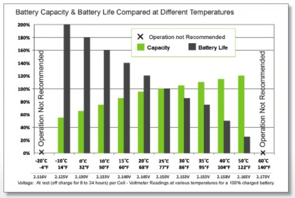

Coming off a cold michigan winter, your capacity could be toast, cold is great for battery life but it sucks capacity... Hemi's need that 695 CCA+, if it doesnt get it you will have intermittent issues. Next time buy an h8 instead of h7, make sure you can fix the tray so it wil sit. Oddly enough h8's tend to be cheaper and have a larger capacity, might buy you an extra year ot two.
