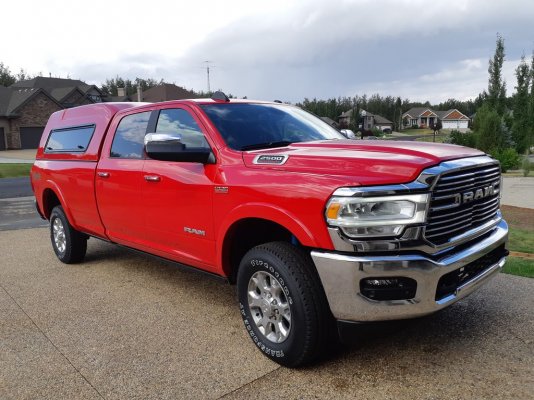

2021 2500
Best bet is the power boards. I have the factory ones on my 2021 2500 with the Offroad package and they are great. Come down well and lots of room for your feet. The problem with fixed boards that are a bunch lower is hitting stuff off road. These suck up tight to the body when not in use.

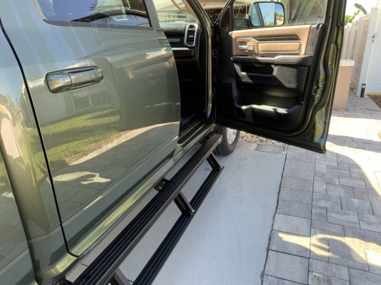

I have Aries power steps. Easy to install.
