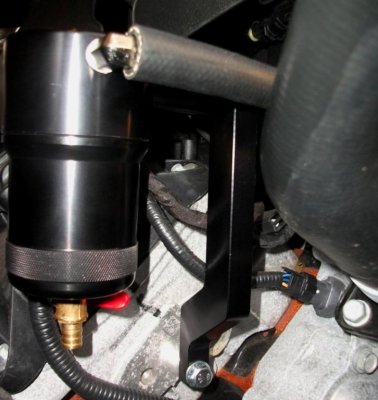

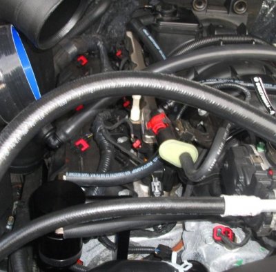

I installed the Billet Technologies kit from Moes. The 'Z' bracket makes installation a snap.
The UPR catch can is very similar (has the z bracket) but I think it has a better oil catcher.
On eBay: search for: black billet catch can
Both of these come with the correct hoses and fittings.

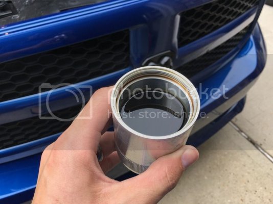

This is what I collect about every 2500 miles in my truck...
