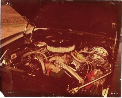

I originally did a single remote filter,then upgraded it to the dual set-up.There's a noticable differance in oil temps between the single and the dual,and a huge differance in temps between the stock filter set-up.Originally my truck probably ran comparable oil temps to your's,which i wasn't a huge fan of,and i've had a fair bit of experience with remote filters,so the stock set-up didn't last all that long,lol
Old single set up.
This pic is from 1984 and the dual filters had been on this car for a couple years by the time of the pic,lol
