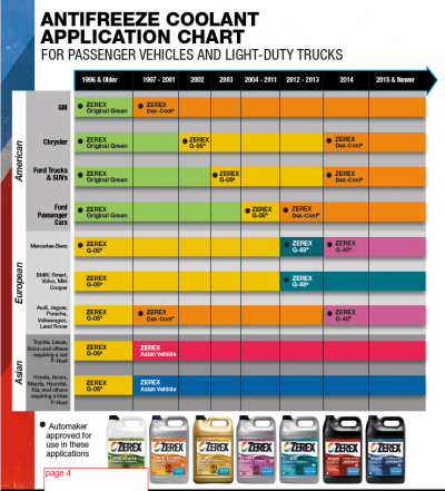

Awe, interesting thing if your truck is 2013 you need hoat not oat, appoligies...
So there are really only 2 options I know of, mopar hoat 5 year, or zerex go-5, which is yellow. Peak global life will not work as good as it would with oat mopar 10 year.

The HOAT vs OAT thing is weird. Apparently this changes in 2013, and the manual calls for OAT, but whether it actually got HOAT or OAT may depend on manufacturer's date of that specific 2013 ram. How bizarre.
If the dealer does a full coolant flush, couldn't I then put in whatever coolant I want to use moving forward? So whether my truck orignally got HOAT or OAT, I can just replace with MOPAR OAT 10 year?

Correct- page 134 of 2013 owners manual, so the chart is off by a year. good catch
So universal is back in play.
