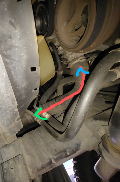

Think I found the hose, it's labelled RAD. So do you recommend removing the green arrow clamp (hose goes horizontal with the ground forward towards the grill) or the blue arrow clamp (hose is going up towards the roof) in order to drain some fluid to make space for the RMI25 in the rad and to check the color and condition of current coolant?

I'd use the drain petcock on the rad,you pull that hose,and it'll be instant dump and mess.Take a flash light and look at the bottom side of the radiator and you'll see the drain petcock.
